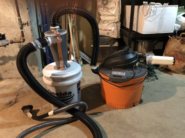

    CA3DC4FE-D518-4D3A-8FE8-3142B592944D.jpeg ...this is how I run! Per the Googlenet, about 95-99.9% of whatever your vacuuming goes into the Cyclone and what’s left goes into whatever vac you have! All I can tell you is after 1 season/ 2.5+ tons, my Oneida bucket was half full and my shop vac was basically empty...the blue hepa filter looked brand new and my paper bag filter had black dust inside it past the rubber seal but the bag felt real empty. The only inconvenience is it’s a little cumbersome carrying up and down the basement stairs, so I carry it carefully like an old man. Okay, I might be an old man.
