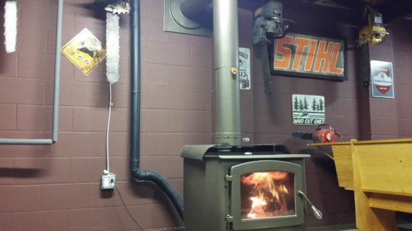

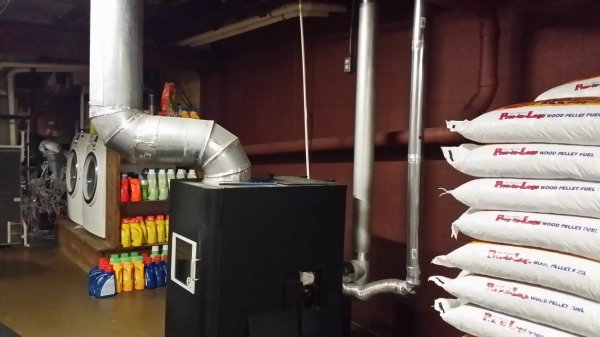

    I used the rigid dryer vent for two of my three OAK's (the 3rd is Selkirk DT). These are built better than any OAK system besides Selkirk DT.
    I wouldn't use the exterior cowl either. But the flex or rigid has a plenty high enough heat rating.
