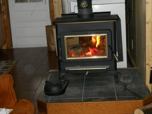

  20. yooperdave
    34,293
    212,430
    Here is a pic of the stove (13) at the cottage and it shows the heat shield attached to the side with the combustible wall on the right.
    For size reference, the tiles are 12", so it looks like the actual stove is about 10"/11" from the wall not counting the heat shield. The heat shield looks to be a little away from the stove near its bottom, that is because I did not specify the shield to have what is called a "cross break" in it. A cross break would prevent the metal from expanded and forming a twist as it heats up. My bad.
    The back of the stove is next to the range...by about 12"-14" as I remember. The side of the range does get a little warm,,,but not that warm where I can't leave my hand on it for any given time.
    The side wall is clear-coated pine and have never had heat issues or any signs of blistering or any other evidence of heat.
