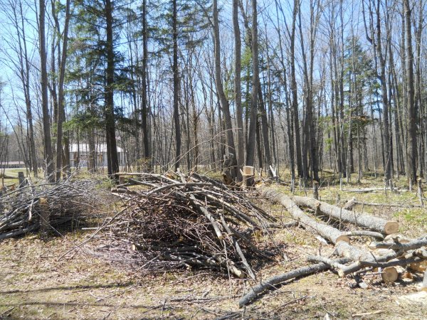

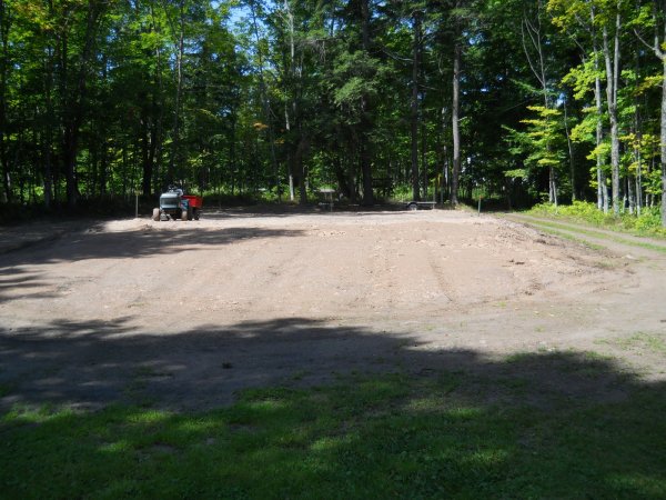

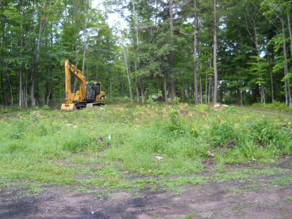

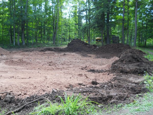

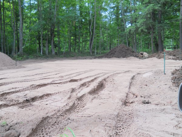

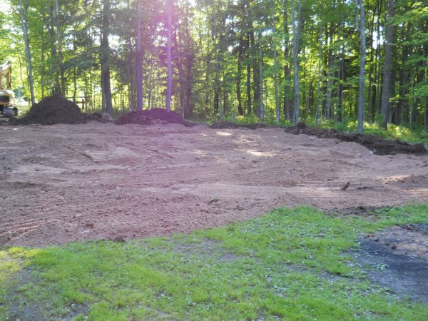

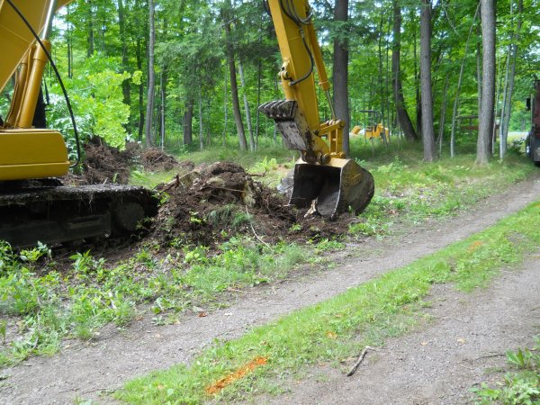

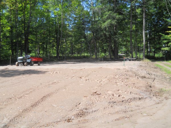

    This is the project that was started about 4 years ago.
    You can see that everything was excavated and pit run hauled in for fill, then sand and compacted. It is about 10" high at back part and about 3' high on this end.
    Plus the 4 winters of snow helped with compacting and settling.
    That is why I'm wondering if the foam underneath the slab is necessary?
    Originally sized for a 30' by 40' garage.

    You are looking good, having excavated and imported great fill materials that has had 4 + years to compact. Your question involves moisture not compaction. You have the compaction handled. But, all concrete is going to weep moisture from the ground no matter what material is the base. At a minimum, 4 to 6 mil poly vapor barrier under the slab. Foam will help if you ever want to heat the building. It will prevent the frost from coming up from under the slab. The reason some guys don't want to put it under neath is because it takes the concrete longer to cure because the moisture can't get away by draining out of the bottom.

    As said foam (in this case) isn't there do to poorly compacted soils. Allowing your subgrade to go through several freeze-thaw cycles and using a pit run was a good idea.
