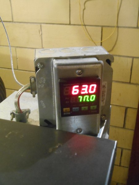

    I put this temp controller on my Tundra wood furnace. It already had a simple 24VAC driven damper motor controlled by the Tstat, I dropped a K type thermocouple in the stove pipe and wired this cheap chinese made PID controller (Mypin brand) in so that when the exhaust hits 550* it closes the damper, when (if) the exhaust temp gets down to 350* it will open the damper back up (if the Tstat is still calling for heat) You can program the controller to do a bunch of different stuff. It even has a "autotune" feature that can "learn" to control the temp to a target temp.
    I have about $20 in everything buying it off the fleabay.
    Probably a little different than what you were asking about...but if you bought one of these Honeywell damper motors and a transformer, it wouldn't be that hard to hook it up to a stove. On the Tundra the motor is just hooked to the damper door by a piece of wire, (looks like coat hanger wire)

    That's a very industrious use of a few cheap control elements:thumbs:
    The concept and application on a furnace setup makes sense.
    When put on an insert or free standing stove you'd need more Integral and not on-off control mainly because they don't have forced draft fans. Secondarily aesthetics, unless a stove manufacturer integrates the product into the design it'll probably never take off.

    No forced draft here. The Drolet Tundra wood furnace is basically a 3+ cf EPA stove turned into a furnace
