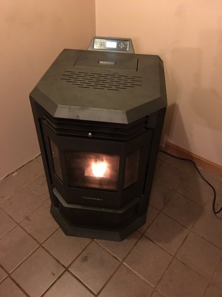

    Hello
    New Ignitor and Pellets in Hopper

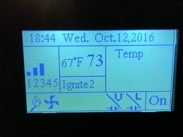

    Stove cycled from:
    Ignite 1
    To
    Ignite 2
    To
    Ignite 3
    Then
    Error 3 - "Not feeding peleets." Must be pellets in Chinese
    Red fault light came on...

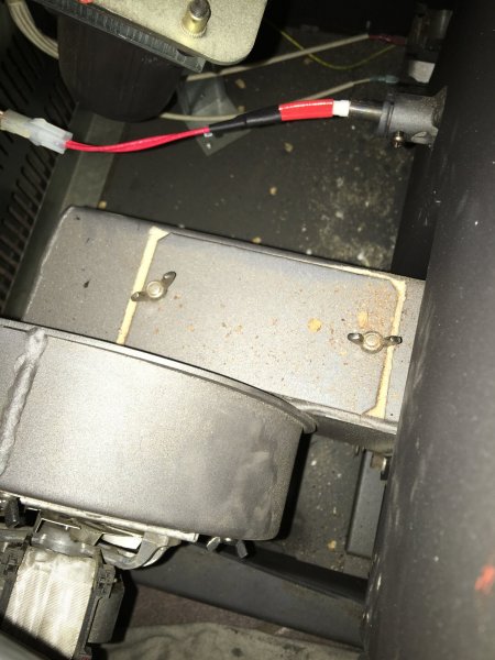

    1. Cleaned stove and blew out ash trap with compressor.
    2. Ignitor loose and pulled back
    Pushed Ignitor in and tightened.
    Now I can see and feel hot igniter.
    3. Damper pushed in and tightened down
    Loosened damper, pulled out damper quarter of the way and retightened screw.
    Now I can feel air drawn into back of stove.
    4. No gasket in burnpot Ignitor hole
    Cut Lytherm and put one in.
    Burn pot gets nice and hot
    5. Venting completely clogged with ash
    Cleaned out ash.
    Still would not light!!! Go outside and feel absolutely no air coming out of exhaust pipe?
    Finally pulled out birds nest at top of venting
    Stove lights up on
    Ignite 1
    Whew!
