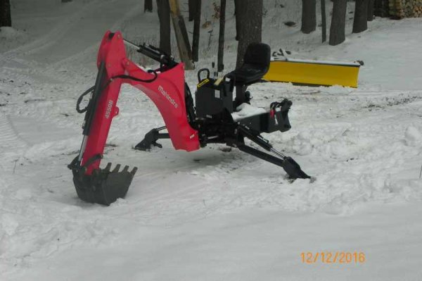

    Ok maybe I missed it in all the diesel talk here but what are we warming up to start? :popcorn:
  17. thewoodlands
    thewoodlands
    15,040
    62,334
    I took some weight and length off the back end today.
  18. thewoodlands
    thewoodlands
    15,040
    62,334
    The engine block heater, it then changed over to talking about the diesel.
    Doesn't the diesel get changed over automatically to winter blend like gas?
  19. J. Dirt
    J. Dirt
    3,482
    18,254
    Haha sorry I was talking about what the block heater was on as in tractor pictures :D as far as the winter blend fuel I'm not sure if they do it anymore or not and if they do i think it can still gel
