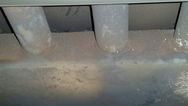

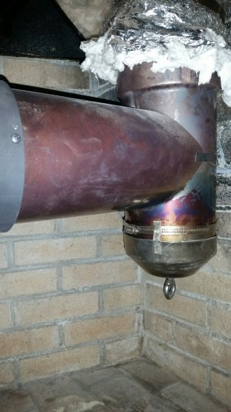

    I snapped some pictures today of the set up. It is hard to see details on the chimney cap; it has a mesh screen around it.

    The chimney is a masonry and is outside the house. The SS liner is insulated, Fireside Chimney Supply FireFlex Insulation Wrap 1/2in - 3in to 6in liners (25ft), liner is Fireside Chimney Supply FireFlex 316Ti Basic Flexible Chimney Liner Kit - 6in x 25ft.

    After seeing those tubes, I'm now wondering if they aren't robbing the whole system of heat. It's not going to be a real efficient stove anyway, which means a lot of particulates going up the flue, then add in the heat robbing tube deal and possibly not ready for prime time wood, you get creosote.

    Papadave, I was thinking the tubes may be hurting my flue temps, but wasn't sure it's blowing enough air. If I wasn't so lazy I would run some arbitrary numbers and determine a rough % drop in temp. I basically researched the hell out of everything, I paid to have the liner and stove installed, I did everything else, wrapped it, uncoiled it. I new I would never be efficient burning wood, I bought the stove knowing I could go 12 to 18hrs on coal without touching it; however I thought I'd be able to burn wood in it. I also under estimated the coal ash.

    Ok, so the consensus is, wood is not ready and I'm burning too cool and too slow to get up to temp. I haven't tried burning without the tubes/blower running, I'm afraid of damaging the unit. If I mess up the tubes I have lots of welding/grinding to do as they run thru the fire box. I have a manual, but it covers burning coal, and the only mention of wood is kindling for a coal fire. they are not allowed, EPA, to advertise wood burning. The top knobs, for coal anyway, when open cool down the fire box, I'm not sure much of this air makes it to the fire or creates a vacuum to allow heat to go up the flue versus hang around to create actual heat in the stove/room. When burning wood, it creates a turbulent burn and flare up/die out cycle with puff back, sounds nasty, and like a chimney fire is starting...which in my experience is terrifying.

    The tubes can not extract enough heat to cause your issue, moisture in your wood is #1 problem. Now, I haven't burned splits in decades but I remember my father's advice burn only well seasoned wood three year split and on the stacks. In other word cut, split, and stack for 3 year from now. I seem to recall 15% to be he ash weight for a good hard coal, used to burn a lot of that stuff years ago, like 26 years ago or so.

    I'm not sure if you'd get any more heat from those tubes than I do pulling heat off the outside of the stove with a blower and deck, so ............?
