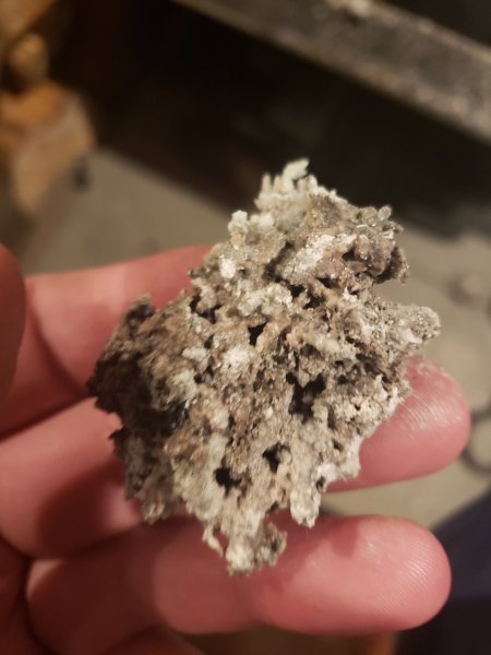

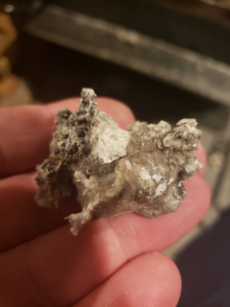

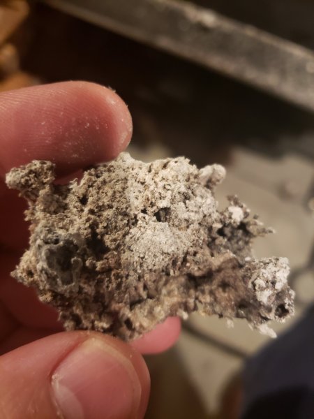

    Been burning only elm for the past 2 weeks, and have noticed hard chunks of something in my ashes. Pulled 2 out tonight to get a closer look. I am pretty sure I read something, maybe on here about certain wood that leaves them, but couldn't find it. 20211109_221833.jpg 20211109_221839.jpg 20211109_221918.jpg 20211109_221922.jpg

    Those clinkers are from the silica in the wood. They are essentially glass. I get them too on certain wood I burn. I did get them also with Elm as I remember.

    I'll get "clinkers" or fused ashes close to where the input air comes in at the 'doghouse'. Sometimes I get a pretty good sized 'pancake'. It's probably related to heat and maybe some excess minerals/silica in the ashes. Weird though, the formation(s) aren't consistent day to day, week to week. Mostly with oak.

    Not abnormal. Mineral residue. Sometimes it will adhere to the firebrick floor and become a minor nuisance. Burn on!
