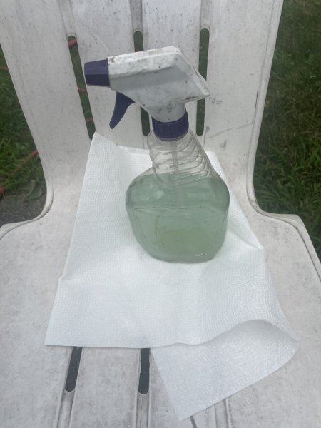

    2. Using a gentle cleaner, spray on plastic headlight lens and wipe off the dirt. I used a vinegar solution in a spray bottle.

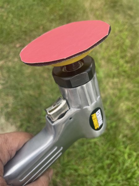

    3. Use special plastic cleaning polish like Meguires PlastX Polish with a high speed polisher. I used an HF air polisher 2400 RPMs but a 15,000 or 21,000 RPMs would even be better. Apply and grind polish.
    I removed the application from the polisher and manually spread the polish all over the plastic lens. Then put the pad on and polished until the lens was clear.
    Repeat step 3 three times to complete the polishing.

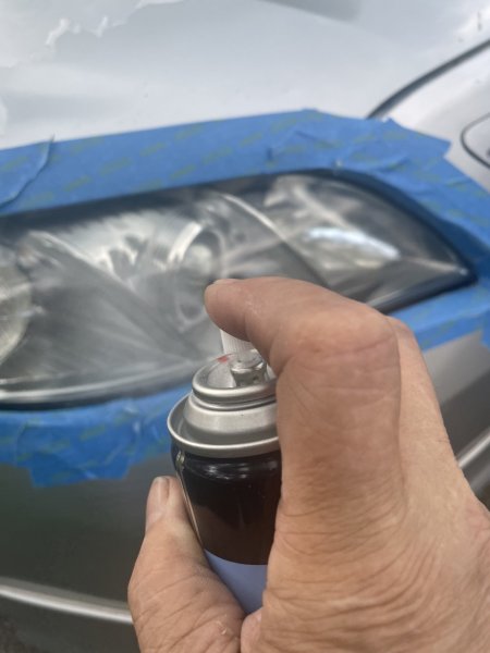

    6. Spray on the protector 1st coat and allow 3-5 mins to dry and spray on second coat for a lasting clean shine.

    This Meguires headlight coating is made for plastic headlight lenses and has UV blocking so it lasts about 2 years. :)

    The way i was shown was to use 400/600/800/1000/1500/2000/3000 grits with water and then a plastic polish to get rid of the haze. We used 3" pads and sandpaper on a die grinder. Pads and sandpaper where made by 3m.
    Tape all around the headlight on painted surfaces. In case you slip, paint doesn't get nicked up. Each step of sanding you're looking for a uniform "scratch" pattern for each grit. Gotta work out the previous grits scratches. Slow process but very rewarding. Can restore almost any headlight this way.
