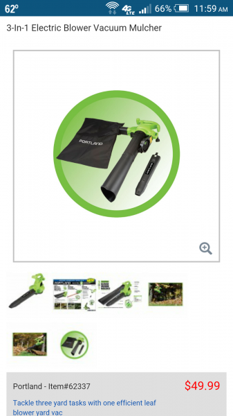

    This can usually be had for $40 at Harbor Freight with a coupon. I have a Toro but this should work the same.
