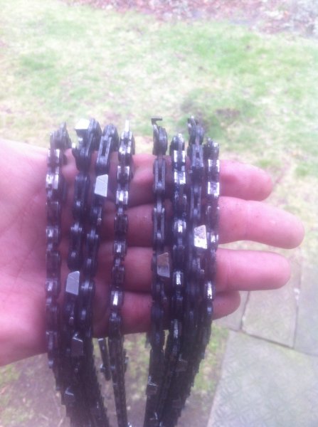

    So part of the best practices should involve not getting them as dirty in the first place.
    For a cross cutting chain, if its sharp and you're getting enough oil, it stays pretty clean. But a milling chain is typically starving for oil. The links are oiled on the top side of the bar, most of which gets rubbed off as its being dragged through a wide cut to the bottom of the bar, where the cutters actually engage.
    I rediscovered a trick today that I first read about in "Chainsaw Lumbermaking" by Will Malloff. I was a little low on bar oil but I wanted to make a couple cuts on the walnut today during a little window of nice weather we had this morning. So I just grabbed a couple partial bottles of engine oil and about 1/3 qt of transmission oil that i had and dumped it all in my bar oil container.
    The gear oil seems to help it "soak in" to the DL better, and keeps them oil-ier for the round trip. It can be a little messier though if you thin out the bar oil too much. I ran about 1/3 gear oil today and that seems just about right.
    I only ended up making one cut but I'm very happy with how clean the chain stayed. This is a 172DL chain, and the cut that I made was 4' wide and 7-1/2' long in walnut. The links still feel oily and I won't bother cleaning it this time.
    Chain on the left is one that I cleaned and didn't use yet. That what the one on the right looked like that before I made the cut.
