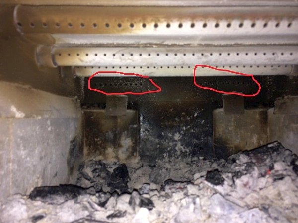

    Stove burns cleaner if I open air up some ,after 2 3 hrs , no smoke your burnin clean
    Does your 1250 have the secondary holes in the back also ,like my 1750 ?

    No, the 1250 doesn't have the extra secondary air holes that he 1750 has. Why?

    Just wondering about the secondary air holes in the back, so far I think the Liberty has them and my stove as them.
    As far as increasing the air, I'm not talking about waiting until the stove is coaling, my stove will burn four to four and a half hours before it starts coaling, on a full load
