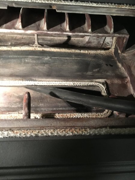

    Had some warm weather, so we stopped the PH and gave it a good cleaning. One place that it a bit hard to reach is where the smoke leaves the firebox, at the front, and travels to the back to then loop up around and come forward through the cat. That smoke passage gets a fuzzy deposit on it over time, and ash accumulates in there. In the pic below I've removed the cat and the bypass flapper, and am using a piece of 3/4" hose connected to the vacuum hose (using my hand as the seal). It did a real nice job of reaching all the nooks and crannies and sucking out the ash.
