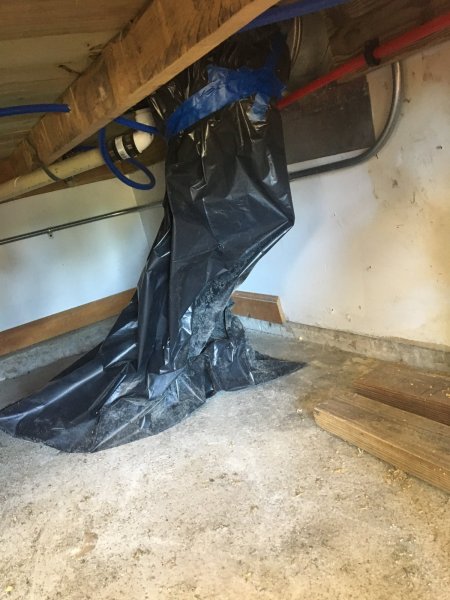

    My cleanout is under the steps in the garage. I tape a garbage bag to it and then I take the cap off to let the soot out.

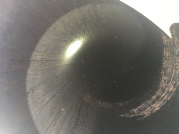

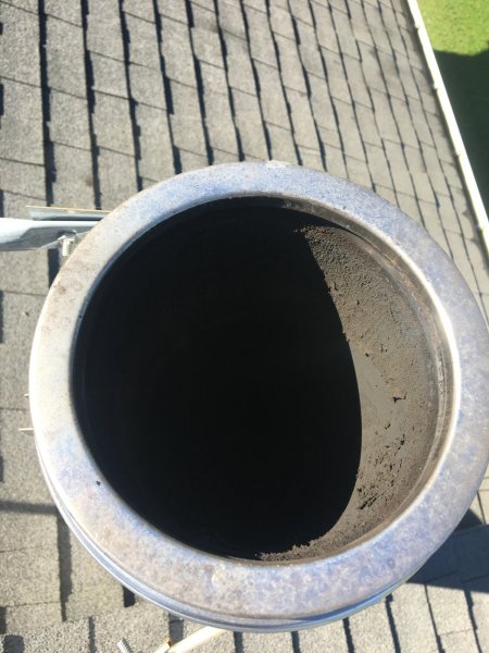

    This is looking down the chimney with the top section removed.
    Same section after cleaning
    After cleaning the chimney I removed the bag and dumped it out and this is what I got, less than a cup.
    I put the cap on and was done. I still have to clean the stove pipe but I cleaned the gutters since I was on the roof. Proof that burning 3+ year dried wood. Nothing to worry about.
