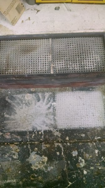

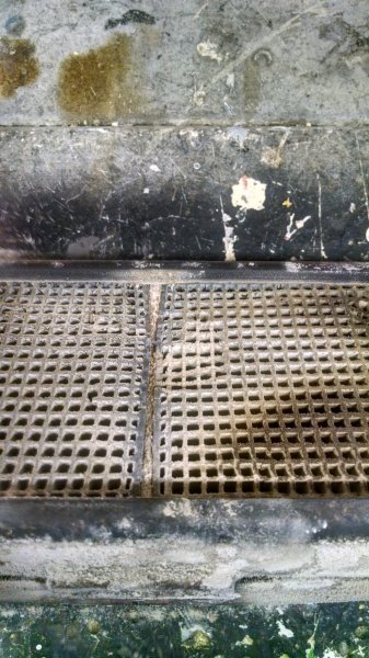

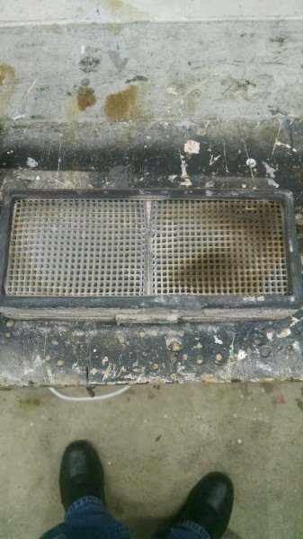

    I think but im not positive this was the original cat that came with the stove I bought in 2010. I had two Keystones and did some cat swapping and experiments between the two.
    Anyways this cat has taken a beating the last couple Winters. I burn it pretty hot mid winter to keep the house mid 70's and lately I noticed I needed to give it more and more air to keep it burning hot so today I decided to take her out for a cleaning.

    She was a little dirty and had some crumbling on the face. Almost looks like flame impingement in some spots. I ran a pipe cleaner through each cell and blew her out.

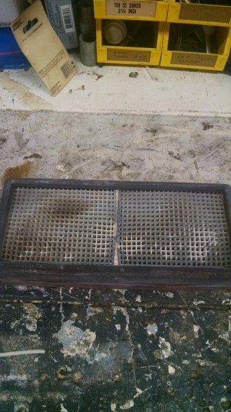

    This what it looked like after I clean it. The lighter spots are the crumbling spots on the front face, they're maybe a 1/16" deep.

    Yep, she's back in there and its better but definitely not 100%.
