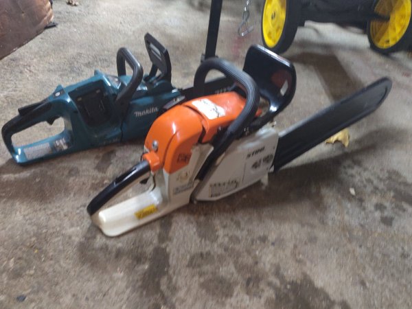

    You'd think I'd have known better than to not clean my chainsaw bars....But I'm a noob and I'm going with that excuse!
    I know, I know....I'm preaching to the choir.....
    Just cleaned both bars on the Makita and the Stihl. Used a file and cleaned up some minor mushrooming as well. But man I was pretty shocked at how much gunk there was in the channel of the bars.
    I'm pretty sure this is why my chain on the Stihl gummed up the other day and I couldn't move it until I broke it free with a file.......And probably the reason why the Makita sometimes just shuts off and goes into "inoperable mode" with the lights flashing......
    Going forward every time I change a chain I will be cleaning the grooves in the bar.....and flipping the bar.....and making sure the oil holes are clear.....
    Little brother and big brother all cleaned up and ready to go.... Woo hoo!
    Except I processed every round I have.....so nothing to use the saws on. I guess it's time to find some more wood!
    First pic is one side and there was more on that side as well. Yuck!

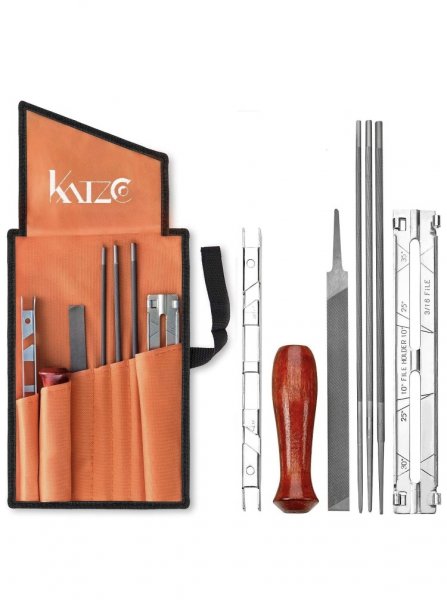

    I have a depth gauge that also works as a groove cleaner. It came in this kit that I bought mainly for the pouch, because I don’t use the file guide, or depth gauge except to clean bar grooves.
