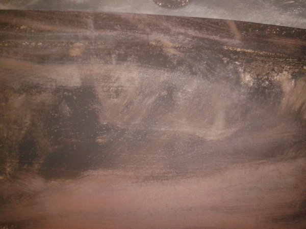

    I took the door off, the secondary plate and the plate above that and cleaned the entire stove in preparation of the upcoming season. I also re-gasketed the window and door. This is the first time I've ever done this, and although the stove has only been through 3 seasons, the gaskets need it. I had a few overfire situations last year. (No red on main stove or warping.)
    The only chitty part is 1 of 2 bolts broke at the head, but it's no biggie. The secondary plate is tight up in the stove.

    These guys gave good info. The ceramic window slid alittle last year and exposed the gasket, so it needed replacement. The door had a thin spot near the handle so I replaced that as well. Easy job, all the cleaning I did & the gaskets took maybe 2 hours total. Cut that time in half next time I do. Gaskets can last many years, but always good to check.
