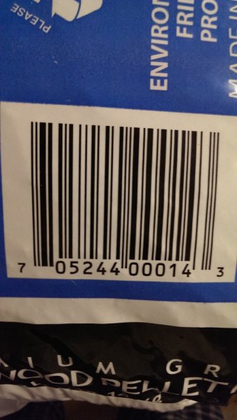

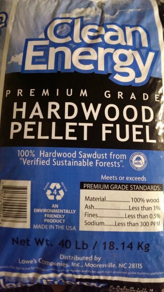

    Clean Energy results: FINAL RESULTS
    Temp Average - 260-340 (on door thermometer)

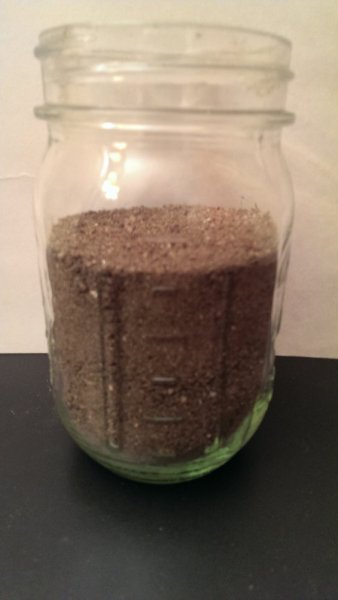

    Ash Volume - 11 ounces
    Ash Weight - 2.0 ounces
    Ash Percentage - 0.31%

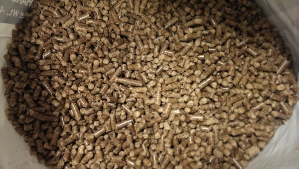

    Fines In Bag - between 1/8 - 1/4 cup
    Pellet Length Avg. - 1/4" - 1" see pic
    Bag Weight - 40.0 lbs. (.372 oz. left in hopper)
    Notes:
    Bought from Lowe's Bethlehem
    $230 a ton
    These are re-bagged Hamer Hot Ones. From Hamer Sales Manager Todd Webb:
    Good Morning Stephen,
    Yes, we did supply these pellets and they are the same production as Hamer Hot Ones as we only have the one plant in Elkins, Wv.
    Lowe's picked these up in July.
    We do not have any additional orders set with Lowe's as corporate places all orders and only purchases based on landed cost. While I am a consumer as well and need to save every penny when possible it is also as important to insure you can get Hamer Hot Ones throughout the season please attempt to support the local dealers when possible as they bring in Hamer Hot Ones year round and have access to them year round.
    Thank you for your support of Hamer Pellet Fuel Regards, Todd Webb Sales Manager Hamer Pellet Fuel
    304-453-6381 ext. 135
    Overall...I like these bad boys and I would have bought a ton if they weren't $230 (I'm cheap!)... I saw someone posted somewhere else that he doubts that they re-bagged Hot Ones ....well, I can only go by what Hamer said in the email and have zero reason to doubt that.
    Disclaimer: as with everything.......YOUR MILEAGE MAY VARY

    UPDATE!!!! Sorry everyone, I f'ed up the ash percentage and Dex corrected it for me.
