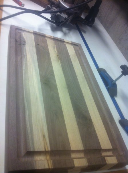

    Now that Christmas is over and these all made it into the hands of their new owners, I guess I can post about this now. I tried keeping it a secret as best I could, but I dropped a couple hints in some other threads.
    The lumber is all stuff that I milled - the walnut came from my sister's tree, and the maple came from one of mine. These pieces came from a few slabs I sawed early on, and that I had stored in my basement over the summer. The slabs were basically ruined for table tops, because they were not sawn or stored correctly, and they dried too fast and twisted and cracked. But I was able to salvage plenty of smaller pieces out of them. :)

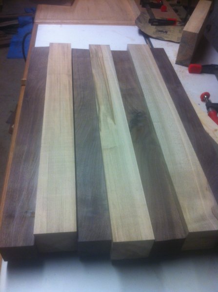

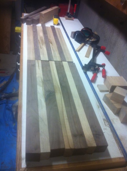

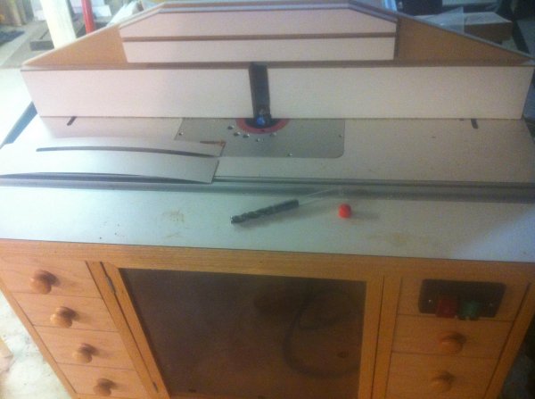

    I started by roughing out the stock around 1/4-1/2" oversize using my bandsaw and radial arm. I don't have a real jointer yet, but I can set up my router station to edge joint pieces up to 2" thick. So I used that setup to establish a square corner, and then my tablesaw and thickness planer to bring them to final dimensions. The larger pieces I took to 1.75 square, so I could rotate them if I wanted and have a few different options for the grain pattern.

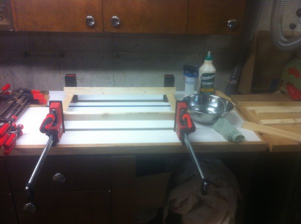

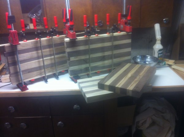

    Glue up:

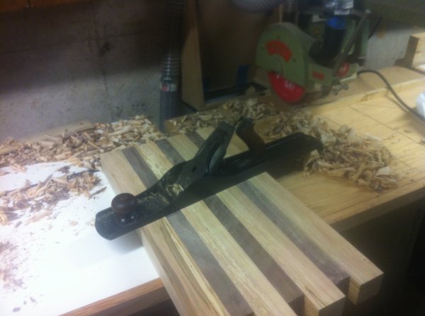

    A few of them twisted a little in the clamps, making it difficult to run them through my thickness planer and end up with a good result. So it was time for a little practice with the hand plane. Then with one side flat, I could take it back to the thickness planer and smooth out the other side.

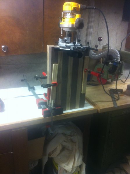

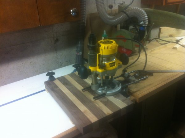

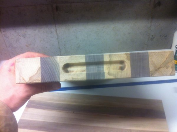

    Some finishing touches with the router. Hand holds along the edges, and a drip channel on one side for meat carving; all done with a 3/4" diameter round nose bit.

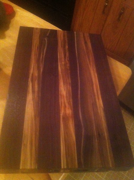

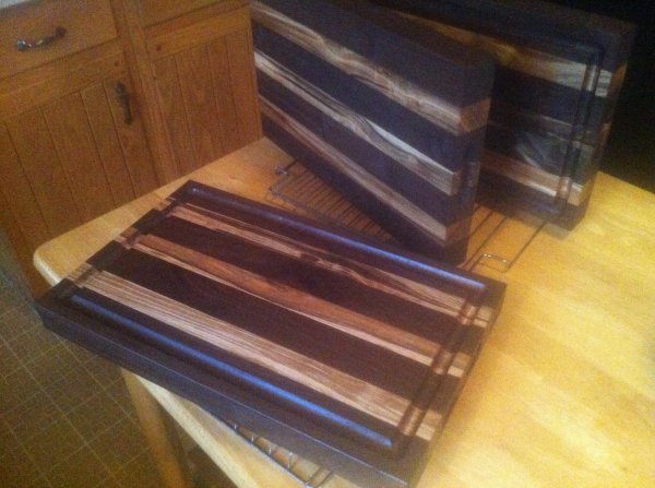

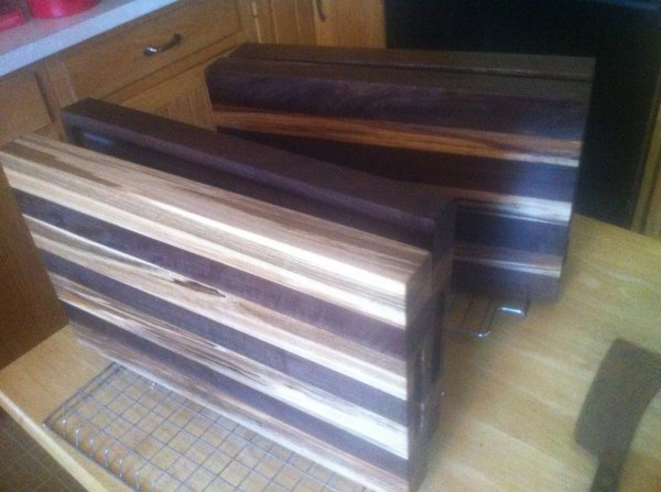

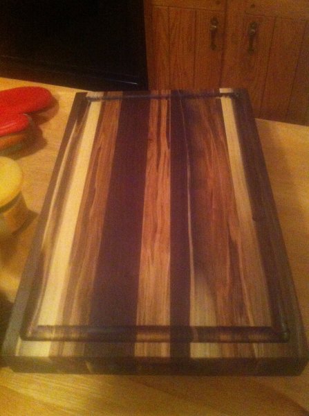

    Here's the results. For the finish, they were soaked overnight in a bath of food-grade mineral oil, then waxed with Clarks Cutting Board finish.

    I made another one of these - the walnut had a bit of sapwood in it, but I'm very happy with the way it blends with the red maple.
