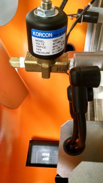

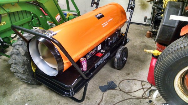

    IMG_20181215_215913383_HDR.jpg so I picked it up, it's a bit bigger than I expected.
    Went for kerosene and the hose won't reach, kept short so people don't put non road taxed kero in vehicles, dang.
    Go back home and get a 5 gallon can and fill it 6 times and pour it in.
    It's up pretty high on my flatbed so I couldn't miss the opportunity to slip and pour it all down the front of me. Dang #2
    204lbs of kero at $142 to fill it. Just under $14.00 an hour to run it.....oh boy.
    Go home and fire it up, burns great quiet to boot.
    Flip it off, it's supposed to do a 1 minute cool down..... Instead it spews burning kerosene out the front and onto my truck. Dang #3
    Take the top off and the solenoid valve is IMG_20181215_200443276_HDR.jpg going into #2 and outa #1. Oh cool..... yeah.
    The nut holding the coil on was so flipping tight I was concerned about breaking something. Although the supply line was left loose even with a QC sharpie mark on it.
    Put my clothes in the laundry..... I see my wife thru them outside....
    I think a cocktail is in order.......
