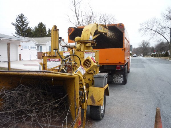

    A chipper is a nice toy to have around. I like this one. 4cyl, 80hp Cummins diesel. :whistle: :)

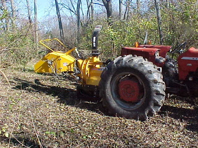

    I bought a smaller unit that is PTO driven. It is hydraulically, roller fed which is super nice. I have been very pleased with it. I did quite a bit of research and for my situation, it was the best option.
    Review of it is in the links below.

    Nice

    If all the usable wood is cut out and I have just a huge pile of brush, I can fill that truck in about 2 hours.
    And you're right. The big ones are wicked expensive. In 1998, I bought the one pictured above for $27,000. They're going for nearly $40,000 now.
