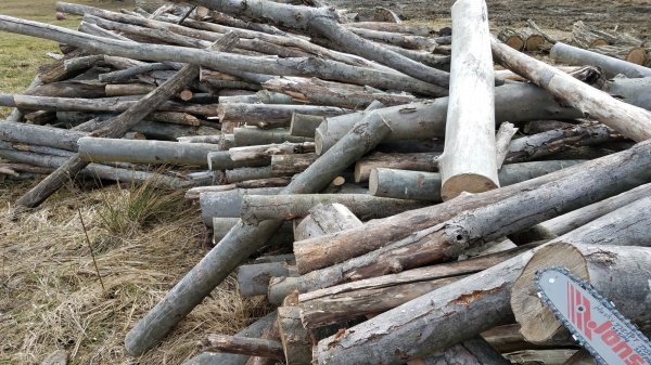

    I ended up with a couple dump truck loads of mostly silver maple, 8"& under (mostly under).
    We cut up a couple pickup loads this past fall with the 028 and Husky 55 Rancher. I have a couple Stihl 192TC s I bought for cheap but they need some more work. afleetcommand had one of those little Chinese saws on one of his videos a few weeks ago. Hummmmm....I thought.
    Ordered two. I didn't realize they didn't come with a bar and chain. When I did, I went to add them from Hutzl and it was going to be 32.00 with the additional shipping. Yesterday I went to a shop in Middlefield recommended by a member here. After some trial and error, we came up with a solution. I bought two Jonsered bars for 8.00 each. I also had them make up a few Oregon chains.
    The bars needed a slight mod to the oil hole in order to work. A 3/16" endmill and about 10 minutes did the trick.
    I have to say, chain tension adjustment aside, my first impression is it's a handy little saw. Clutch slipped at first but a little non chlorinated brake cleaner and it's better. Still slips, but will cut fine if not pushed. The largest I cut today was about 6-7" in diameter.
