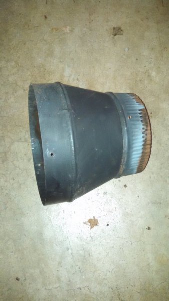

A few things: I had an f500. The first year I ran it into an 8" T then up 25' of 8"ss liner. It performed so so. The second year I dropped a 6" liner down into the 8" then to a 6" T. Noticeably better performance. I'm not sure about the castine, I've heard it needs a good draft. Anyway, I have a princess insert now and still have these parts. I have a 6" T an 8" T and the 6" to 8" reducer/increser thing. Let me know what your friend wants. He makes a small donation to the Phil chity avatar fund and its his.
