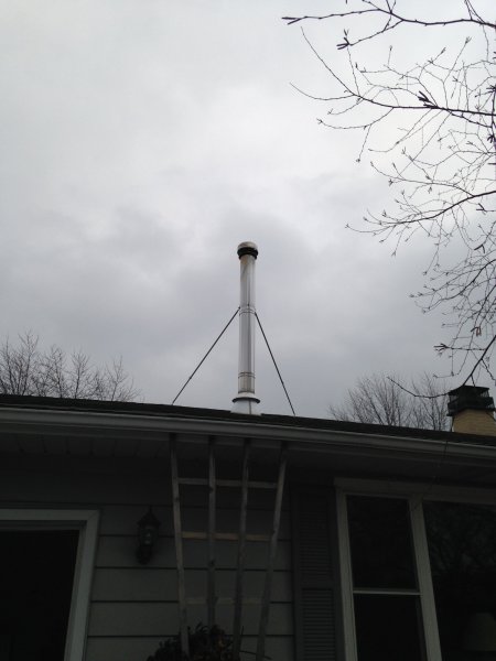

  8. chance04
    chance04
    Mar 7, 2015
    476
    1,081
    Denton Md
    This pic. I see what appears to be two 4ft sections and perhaps a foot or so protruding from the roof maybe part of the support box? Suppose you had to add another 4 foot section to the top of this. I would assume a second brace would be needed but the legs would need to be super long like 10/12 foot (I didn't take the time to do the math of the hypotenuse ) that's acceptable?
    Sent from my SM-G900V using Tapatalk
    wildwest likes this.
  9. MightyWhitey
    MightyWhitey
    Sep 28, 2014
    1,746
    6,311
    I have just over 7 feet of Class A above the roof line. Those are 3 foot sections you're looking at in the picture. My roof in 4-12 pitch. The braces telescoped out quite a ways as I recall...............though I didn't need it all.

  12. Kimberly
    Kimberly
    Mar 19, 2015
    5,072
    12,818
    The Kangaroo State
    If you think you will need some braces longer than the standard brace kit, you can use metal conduit to make the legs; 10 foot sections can be joined with the conduit connectors and the conduit can be cut to the lengths you need. I don't think you need pipe heavier than metal conduit but others can answer this better than I. Or if you do, then the home improvement shops still carry galvanized pipe.

  15. Scotty Overkill
    9,612
    64,492
    I have close to 8' of class A sticking up through my roof from the stove in the kitchen, I had to make my own braces. I used 3/8" stainless steel rod for the long braces, and welded stainless tabs on either end to affix them to the flue and roof. Works excellent. And that stove has EXCELLENT draw, being it's 21' in length.
    MightyWhitey and chance04 like this.
