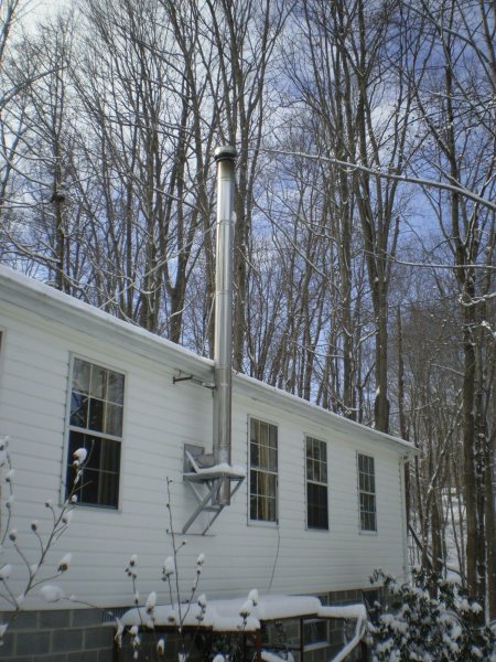

When I was out taking shots of the snow I looked up and noticed a bit of snow hanging on the chimney; this was around noon or so and I did have a fire going well by then. By the way, notice that my house is no longer green, sister came over before it got too cold and helped me clean the siding. I am still wondering if the draft is enough, I still get some smoke spillage when adding logs; at times rather bad. Could the extra offset from the house affect the draft?
Removing my cap screen cured my draft problem, it kept plugging up. I cannot tell by the photo if yours is plugging, but you might consider that.
I think at this point it is a matter of convenience. Yes, a little longer run will help some but the downsides are cost and aesthetics. If you can live with how it runs than it's totally your call. I don't think I'd worry about the snow buildup- just run a brush through when you can and report back what came out. No hurry unless you notice a problem.
Would think that high up on double wall pipe, with those OAT's, the outer skin would be rather cool anyways?
My chimney cap came with the through the wall kit and did not have a screen; does chimney caps in itself affect draft? There are also some tall poplars (that I wish I could have removed) are very close to the house. I have seen the smoke when first firing tend to blow away from the side the trees are located. I can not drop these trees; I don't have the skill, would need to hire someone and no funds for that at the moment.
The idea is that the inside of the chimney stays hot and it appeares that the insulation in the chimney is working well. It collected on the roof guy band.
It's all relative, if the flue temp is too low at the stove then it will be obviously be way too low higher up the chimney.
