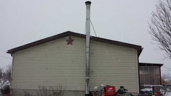

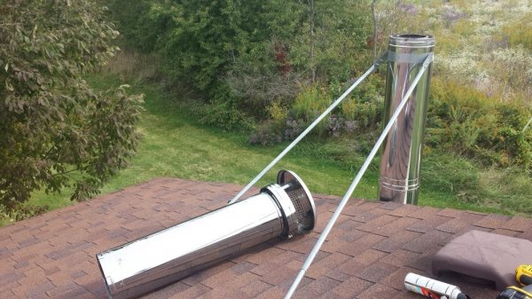

    Top down, but it's the easiest way for me. Using a Lint eater and I have rods and a 6" steel brush.
    I take the top 3ft section off (includes cap) and the hole is just below waist height for me (perfect). I didn't need the last 3 ft section, but I had it and the 18' of vert outside makes the 30 draft nice :)
