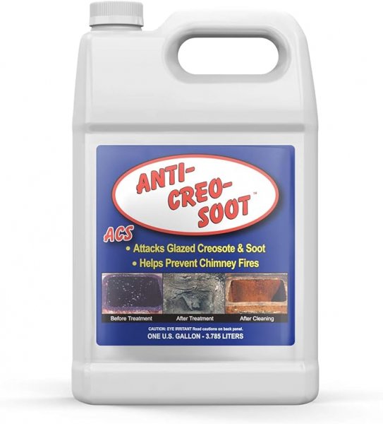

    I’ve used this stuff with decent results.
    Run it up the pipe with a small fire like in the instructions, and toss on a pine mountain chimney log. Also apply it directly on the tough spots at the top. If it’s real bad it might take a couple tries to let it work and loosen things up.
    Also used this through the year.
    People can say what the will, this stuff helps. It not a fix-all or miracle cure but it does help when given some time to do its thing.

    Get a drill attachment with spinning chains. Don't risk one of those chunks lighting up, the remaining ones will likely catch fire too. It's not worth turning your back on, no evidence creosote reducers work. We bought a home with a similar chimney, this worked well.

    They do reduce buildup in your wallet though!

    I posted pictures here somewhere- of a sweep I did after at least 2 years of no sweeping and using the ACS.
    It works. I have gone even longer this time around and I'll post pictures again if I get to it.
    I don't think anything actually removes creosote but ACS does keep it from building up to the point OP posted about.
    I have yet to see any "chunks" it's just dust when I sweep. I've used ACS for 12 years now I suppose.

    A previous Admin here tested a or some creosote logs. They got very hot, hot enough to start a chimney fire for those using them in not well maintained chimneys but his tests did not show removal, just getting it hot. I thought it was in Resources but I don't see it, sorry I can't link it.

    My response to that is, not everything is created equally. I've never tried the logs and don't see any reason to.
    only way this would get very hot is you add more fuel than necessary. since it is a liquid it will actually put out the flame if you don't have a rager going.
