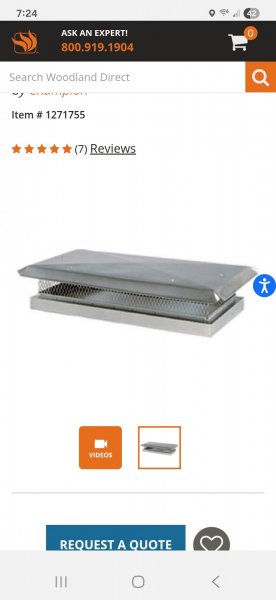

    Secondly, I need to repair my crown up top. My masonry is in very good shape but the crown is showing its age. How do you feel about the stainless chimney caps that literally cover the entire top of the chimney? (See attached photo for reference)
    Being that it’s structurally sound, Im thinking that if I installed one if these it would protect the chimney better than new and reduce my traffic on the roof.

    short answer yes they are worth it!
    Long answer
    Ah I got some hard learned experience in this area. Also have multi story chimney block with brick faced. The chimney and clay flues are fine. 2 Chimney inspectors said so! I developed a leak chased it for 5 years! New roof, flashed twice crickets used a hose. Everything you can think of. a cup of water leak 1 or 2 times a year that you cannot find is tough :hair::headbang:
    Hair line cracks in masonry between 2 flues.
    step 1 repair hair line cracks with appropriate material and seal.
    step 2 get stainless steel cover and install
    Step 3 geo SIL cap every 3 years and it’s never leaked again
    Granted this is over belt and suspenders approach and over kill BUT I hate roofs that leak!

    What brenndatomu said! We have SS chimney caps on both brick chimneys and they are well worth the cost. As is insulated SS pipe!

    I would agree that an insulated liner is well worth the money and performance. Also Chimney RX makes some very good products for the crown repair and or sealing.
