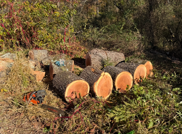

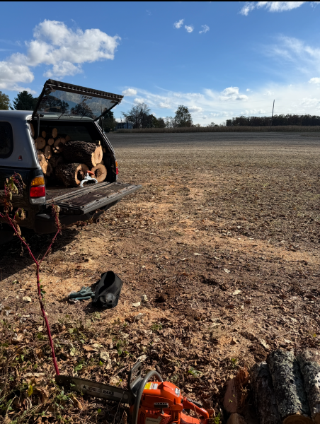

    Couple leaners over my dad’s neighbors field. Perfect day for it too. First was a nice size cherry.

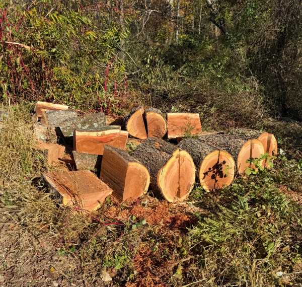

    Couple nice size rounds outta this one. Had to noodle them.

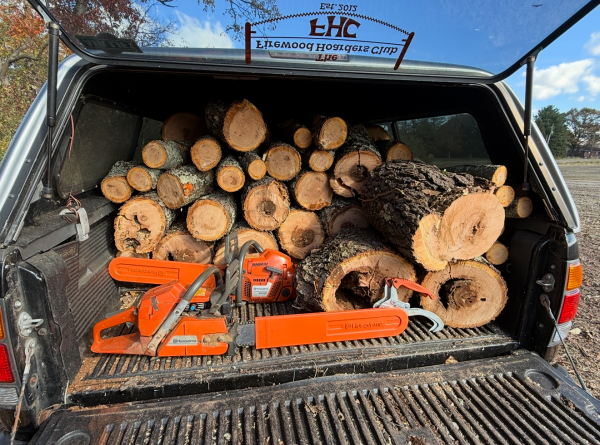

    The sausage stuffed 365sp made quick work of it.
    Real nice size load, only going about 40-50yds across the road.

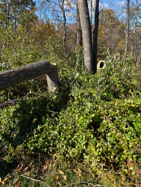

    Then dad wanted to help the landowner out by removing 2 leaners behind their house. This turned into thee scariest moment I’ve ever had cutting trees down. I did not get pics or vids of the situation but all I can say is they’re down and no one was hurt. It ended up being a leaner into another leaner. So I carefully cut a notch in the one that was being leaned into, then back cut, leaving lots of holding wood. I was hoping once I started putting more weight on it with the second one, they’d fall like dominoes. Harrumph. :picard: The second tree, leaning on the first ended up being partially hollow. And it was a decaying ash. :doh::picard: At this point I took a minute or two to clear my escape route a second time. This was sketchy but I was already in too far to let it go. :hair: So.. just as I start my back cut, snap. :bug::yes: The base of this sumbish just goes skyward. :faint: I dropped my saw and ran but honestly, aside from the adrenaline, I felt mighty lucky. The one being leaned on never budged. It acted as a fulcrum and the top of that ash was touching their yard and the base was oh I dunno, 12’ up just sitting there. :faint: Unbelievable. Took my limb saw and cut an outlying limb. Top started rising. o_O So I shut the saw off and started pulling on this medium size tree. Again, very luckily, the first tree started falling like originally planned and down went the entire mess. :bug: Holy crap. :smoke:
    This was the see-saw point.
    I think if I had the canjones and that holding wood was thinner, I would have been ok. You can also see the barbed wire, which is why I went so high.
    We didn’t keep all the wood. Lots had too much decay. I’m really skeptical on cutting any ash trees. They are just too far gone around here for me.

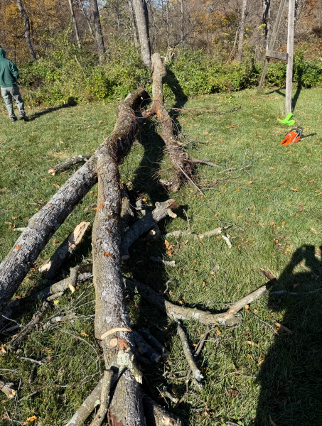

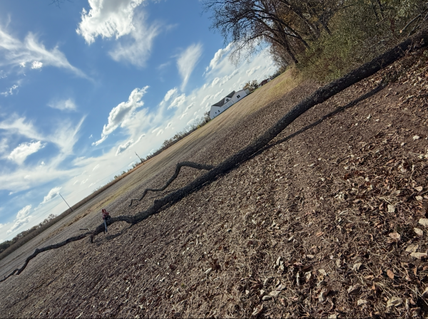

    Then I decided to take one more cherry for myself. Here it is down.

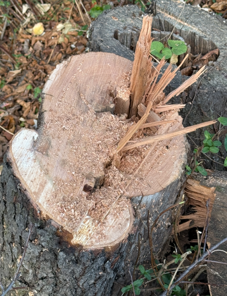

    Heavy heavy leaner, here’s my stump.

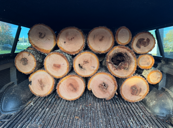

    Fit the entire tree in my truck, even with that little bit of white oak still in there (ya ya, I’ve been slacking). First row had 3 large cherry rounds, second:
    Third:
    And last.

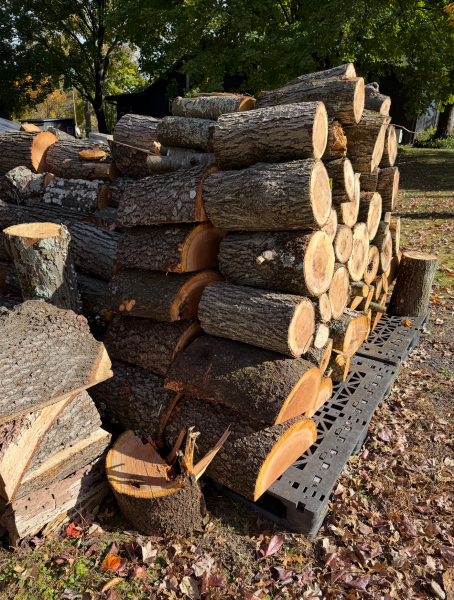

    Dads stack;
    And mine;

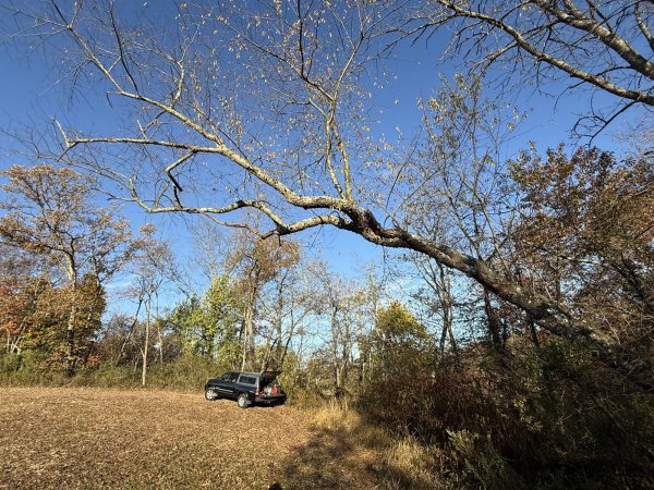

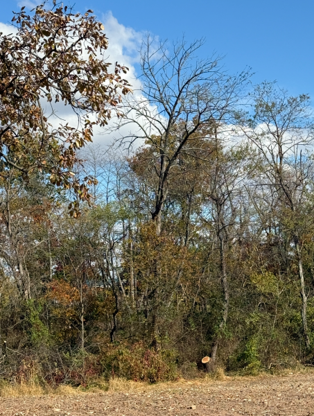

    Here’s my next victim. Believe you me, I will be twice as cautious as I’ve ever been before.

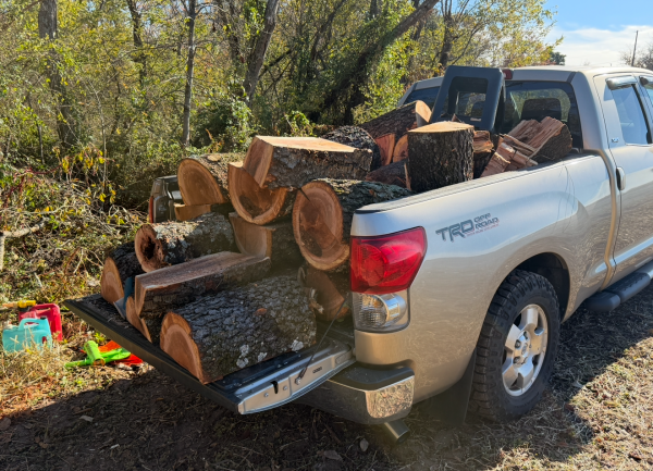

    That’s dad’s gold colored Tundra. Mines still the black one in the first pic. I hate firewood’n with a cap so we use his as much as possible.

    I’m still playing it over in my head Mike. First thing is that first hinge being thinner. And second is I’m thinking I could have made a random plunge cut on the second one, if I had known it was hollow, might not have even tried. Another thing I’ve learned is I’m not great at reading the level of internal decay just by looking at these ashes. The face cut didn’t seem really bad but, I think the back cut side (facing up) was a bit worse. I swear I got about 1” in and it broke free, see-sawing up.
    I’m sure I’ll keep thinking of things. Not something I’ll be forgetting soon.
