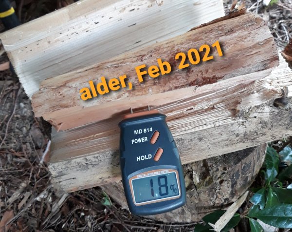

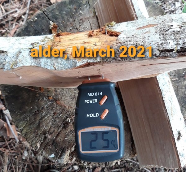

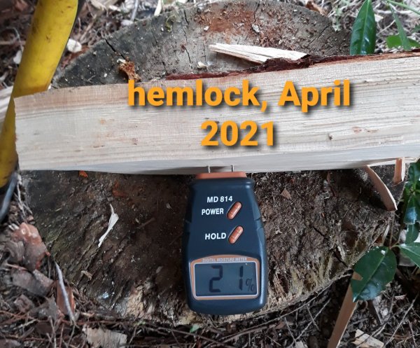

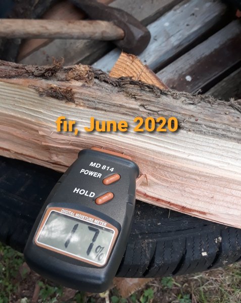

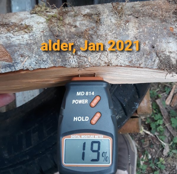

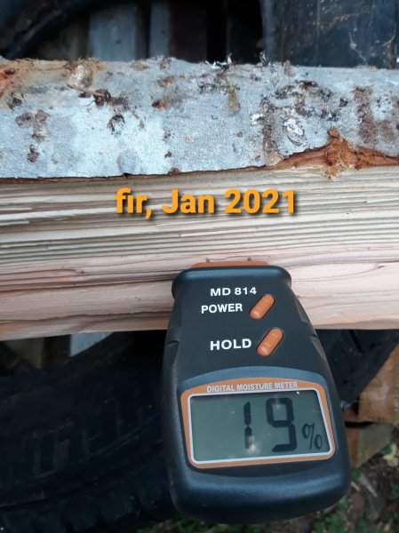

    I split and checked my most recent wood today. There's older stuff in the shed that'll get burned this year. The hemlock and alder over 20% will sit another year. That batch of hemlock ranged from 18-28% depending on split size and if it had bark. The alder over 20% was cut by a county road crew and is longer than the wood I cut myself. I attribute the slow drying to being 18" or so. Another 4-6 weeks and I'll move some of the stacks into the shed.

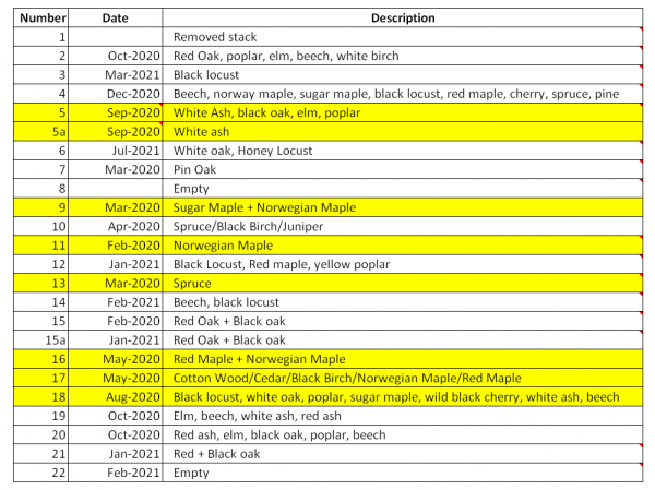

    Highlighted in yellow are the stacks I will cover for tarps before winter for this season's burning.

    I know the dates because I write the month & year on the end of a few splits in each stack, usually with a couple initials for the location.

    One of the things I dislike about hemlock is its inconsistency. Sometimes it's ready in one summer, sometimes it requires 2. Fir is almost always below 20% in one summer and won't go below 16-17% even with 2. The only fir I've had that really required 2 summers has been tight grained old growth, which I rarely get.
