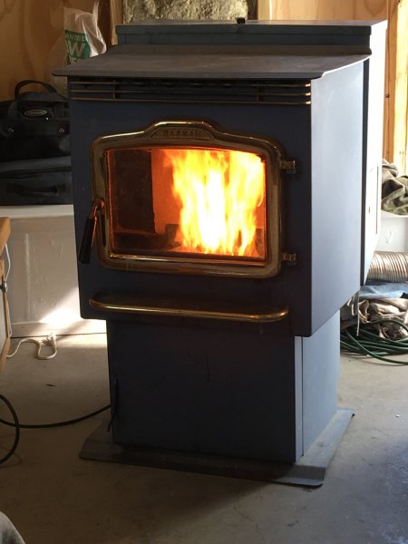

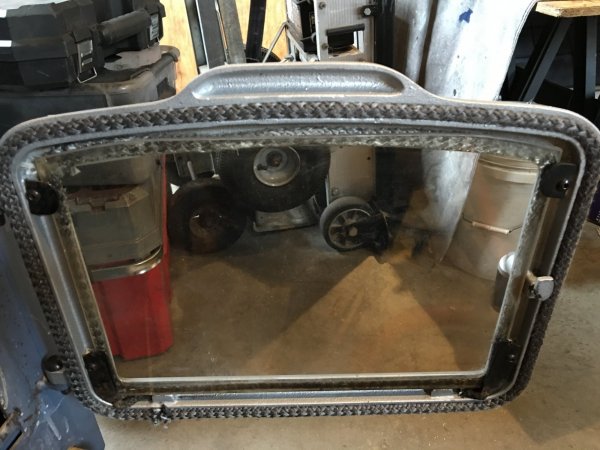

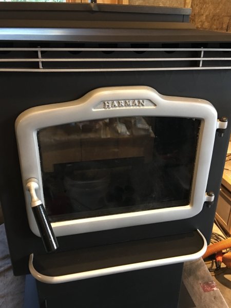

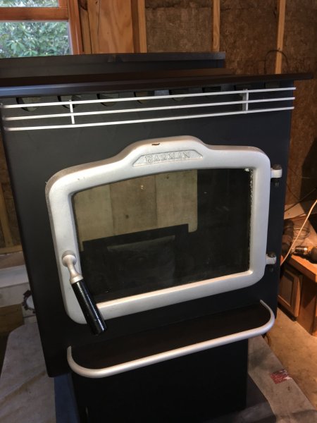

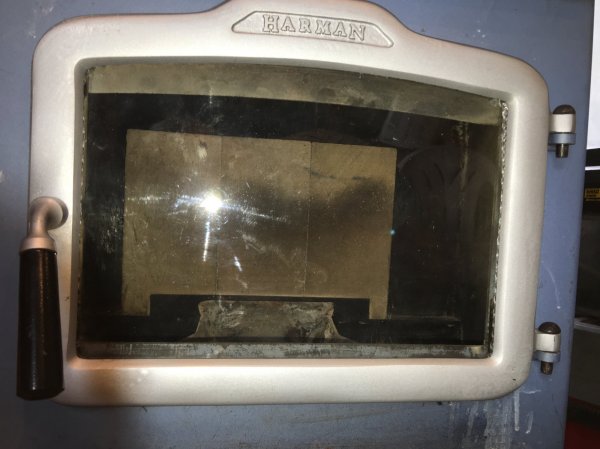

    Since they do get dingy and tarnished, is this a good way to perk them up and look more modern?
    Pic 1 - P61 Factory Blue Harman stove with gold trim
    Pic 2 - VHT flame proof Flat Aluminum
    Pic 3 - painted fire door
    Pic 4 - new graphite impregnated door gasket
    Take out glass and strip out old white door gasket wire brush and clean with acetone, paint and reinstall. Flat glass gasket was still good.

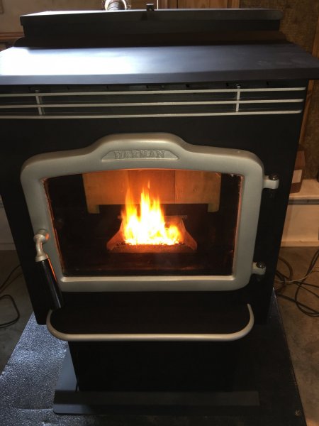

    How about now?
    See pic below:
    bogieb, savemoney and wildwest like this.
  15. subsailor
    subsailor
    3,693
    14,973
    Winthrop, Maine
    Better than the gold.

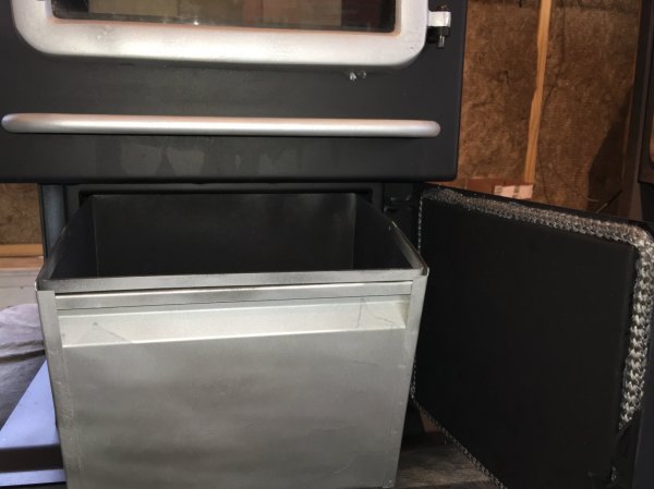

    Another nice thing about the Flat Aluminum is painting the outside of the ash pan to match and Flat Black for the inside and slap a new Graphite Impregnated door gasket on the ash door matches up nice too!
    Click pic to Enlarge:

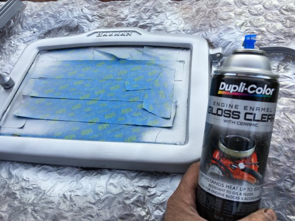

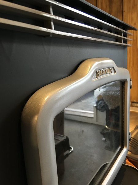

    One important last step!
    After the second coat of Flat Aluminum, comes 2 High Temp High Gloss clear coats. This not only protects the Aluminum Paint from chipping off, but gives that shine you would miss from the gold or brass plating!
    This way you have the modern look with a nice shoe shine!!!
    Very Professional!!!
    See pics

    Stove with fire pic. :)
  20. bogieb
    12,552
    76,344
    Looks like a nice burn - good job.
