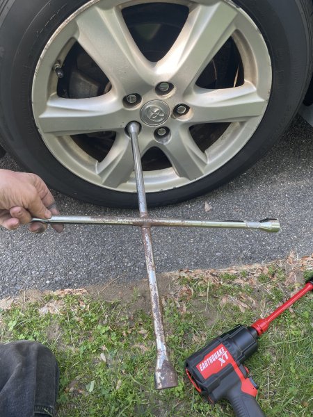

    1. Did not even try the lug nut wrench that came with the car.
    2. Had a cross bar wrench that I could loosen some but not all 5 to get even one wheel off!
    3. Got more loose with the air gun but not all!

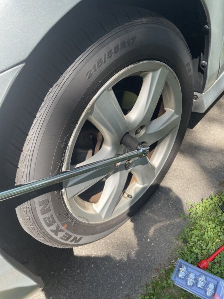

    4. Had an icon breaker bar wrench with a 21 mm socket so I could loosen a few more lug nuts but not all!

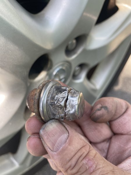

    Some of the wheel lug nuts were distorted and the breaker bar did not seem to grip them properly to get enough torque on them!

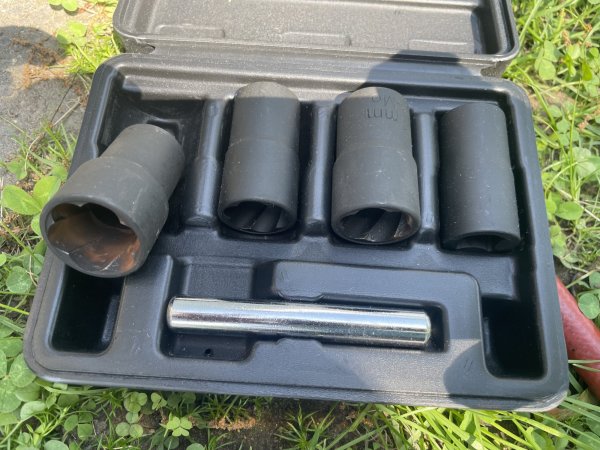

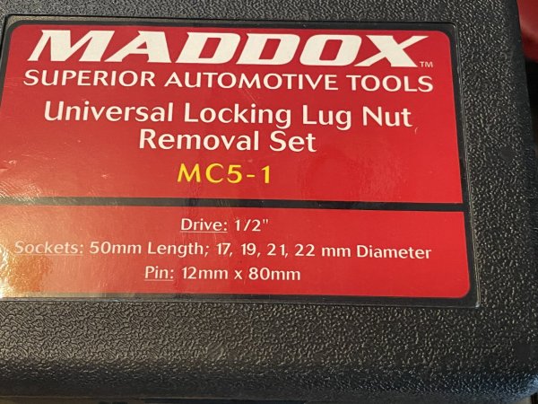

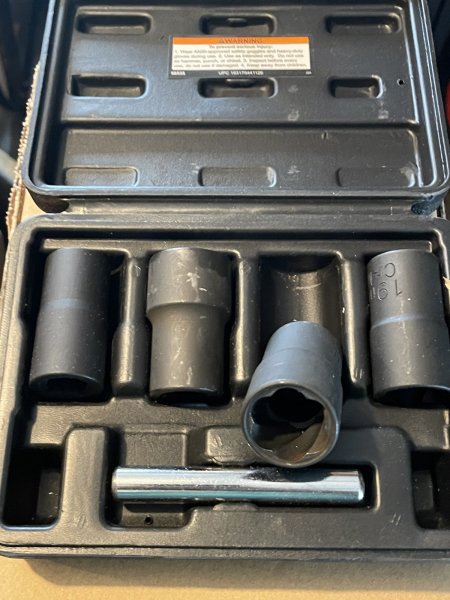

    5. Using a Maddox impact set and a rubber hammer, I banged it on those tough ones and got the grip I needed to get those lug nuts off!
    Thank god but see pic of ripped lug nut? I cannot put that back on! Also had to bang the lug nut out of the impact socket on the bench vise!

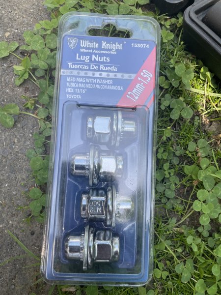

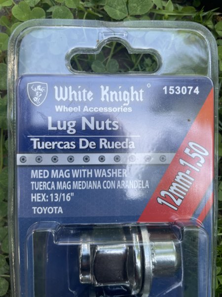

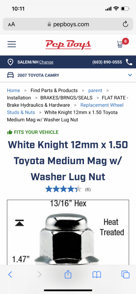

    6. Purchased non OEM lug nuts at Pep Boys
    5 packs of 4 for $7.49 each
    https://www.pepboys.com/white-knight-12mm-x-1-50-toyota-medium-mag-w-washer-lug-nut/product/222260/2007/TOYOTA/CAMRY/4-2362 2.4L DOHC?quantity=1

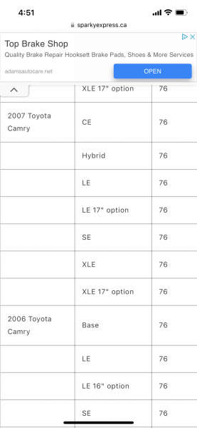

    7. Looked up torque specs for Camry
    76 ft-lbs but many mechanics say more is needed when using aluminum wheels instead of the old steel wheels of yester year!

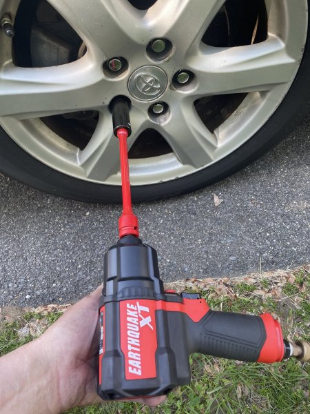

    8. Using a 90 ft-lbs red torque stick on the new lugs, I spun them on with the air gun,

    1. Standard Cross Bar wheel wrench
    2.Icon Breaker Bar and 21mm impact socket
    3. Maddox wheel lug impact removal set
    4. Distorted and torn wheel lug after finally removing it with breaker bar and Maddox impact removal socket
    5-6 New non OEM wheel lug nuts for Toyota from Pep Boys $7.99 for set of 4
    7. Installing new lug nuts with red 90 ft-lbs torque stick on HF Earthquake XT impact wrench.
    8. Manufacturer wheel lug nut torque spec
    9. New lug nut specs

    They may have been over-torqued, soft rims, and possible spalling on the lug/nut are very possible.
    Better to find out now than when sitting on the side of the road.

    stupid covers on lug nuts to make look pretty - things swell wrench/socket don't fit unless you hammer it on/ if you get it/them off have beat them back out of socket. Escape 2016. Two piece nuts - oem save a couple pennies cost you a tow.

    Swollen lug nuts have been a problem for quite a while now. If you are regularly rotating it should be picked up on before it’s a problem.

    I was just talking to the local Toyota Dealer Service Manager and he said the humidity gets into the OEM wheel lug nuts with the decorative chrome covers that all the manufacturers use nowadays (That explains the title of this thread!) and makes them swell and also can make them rust inside! Nothing more reliable than the old lug nuts all cars used in the past. One of my friends put these old ones on and only puts the new fancy chrome ones back on when he sells the car! Great idea!

    The Harbor Freight Maddox set with my HF heavy duty 1/2” breaker bar did the trick. I banged on the 22 mm socket and that grabbed the lug nut hard so I could get it off. It really tore up the crappy old chrome covered lug nut. Lol

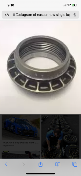

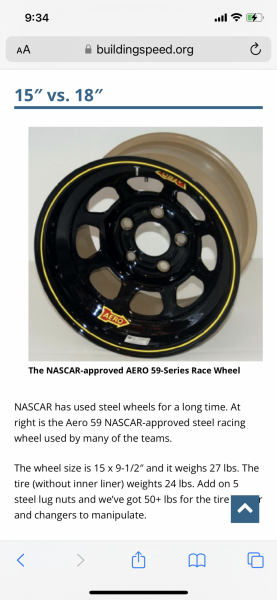

    NASCAR just announced the cars will have aluminum wheels instead of the steel wheels.
    Therefore they know having the old 5 bolt steel lug nuts would be a REAL problem holding the wheels on securely!
    Therefore they invented a large single bolt system specially designed to hold Aluminum wheels on securely!
    Now why didn’t any of the automakers think of this????
    See
    NASCAR moving to single lug-nut design for Next Gen car
    vid 1
    Vid 2
    Reason for new NASCAR wheels
    NASCAR NextGen Wheels: The Scientific Argument for a Single Lug : Building Speed
