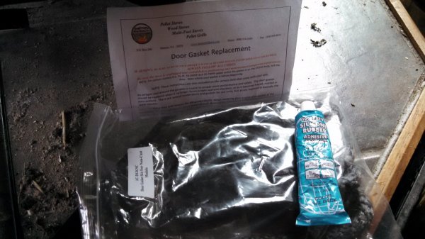

    Ordered a gasket from ESW, which came toady via UPS.

    I was somewhat surprised that they sent normal high temp RTV sealant.

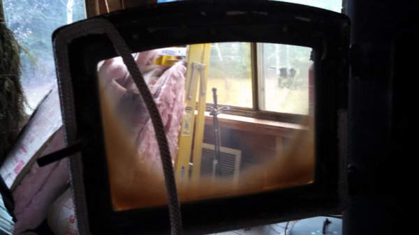

    Gasket cut and rough fit before RTV.
    Sorry, no pic of that.

    The original gasket and this one are very un-fluffy. Quite unlike the Rutland and Imperial I've used.
