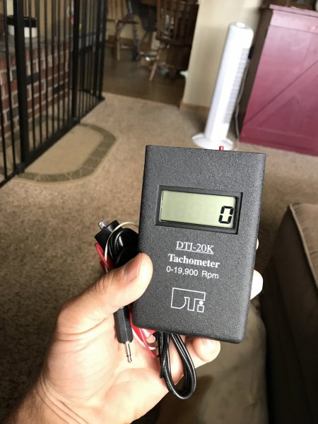

    IMG_1281.JPG Came yesterday in the mail! Ended up working a 24 hour shift into this morning so snuck in a nap and just went out to play!
    It seems a bit temperamental as to where you can hold it when using it wireless, but right against the recoil cover seemed to be the sweet spot since the coil is right there I assume, If anyone had some input about that?
    Anyway kind of neat to see where the saws were at i tested them in a big silver maple round so all saws were full bar length in the wood and it's about 87 out right now too if that makes a difference
    (idle-WOT-In cut)
    372xp xtorq 24" stock maybe 5 tank fulls through it 2800-13200-9800 +-. This saw seems to like to pull down into between 9800 to 7800 and even sit and pull hard at 7800
    55 Rancher 16" muffler modded, port work, carb limiters removed 2700-12500-10000 This saw I bought new in 2004 and has been my go to for ever it always had a 20" 3/8 bar on it and I never had any complaints with that set up but now with the little 16" .325 it's kind of fun :thumbs: even leaning on it she never dropped much from 10000
    Echo 330t 14" muffler mod, carb intake mod, carb limiters removed, half key timing advance
    2700-12800-10000 this little saw has always been doggy til I played with it :cool: now it's not to bad.
    All in all I guess I haven't been toooo far off just by ear although I tend to stay a touch on the rich side blipping in and out of four stroking at WOT and cleaning out in the cut.
    Thoughts?:handshake:

    For tuning I err toward the rich side too. I've had good luck with my 20k holding it by the spark plug in addition to the recoil cover.
