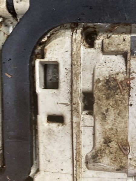

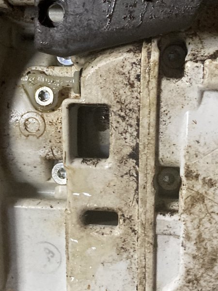

    A8148B03-B283-45BF-973E-5C56B981E5DE.jpeg FBA389D7-8621-488D-8C77-B9492CC02B19.jpeg
    This is the underside of an MS 250, actually 2 different ones.
    top one has the handle bar mount removed and access to the 4 cylinder bolts is easy.
    the second pic has the handle bar mount still on, and access is a little tougher.
    I still would try getting a turn on these and see how that works out before doing too much more.
    Replacing seals or sealant, you have to get to these bolts anyway.
