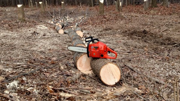

    Just wondering what determines the top rpm's of a motor . Particularly chainsaws . I know some are limited by the coil...but what about ones that have an unlimited coil ? Just a curiousity...as I'm digging the 42/242/242xp/246 lately...and all 4 have different peak recommended rpms.
    Here's a pic of my 242...always ready to cut..fast ! Boy..what a saw :) IMG_20151117_142700429.jpg

    Nice stumps, but there's two more chunks of firewood in each one. Left tall to push over with a dozer?
    As far as unlimited saws and the top rpm. That's the rpm the saw is designed to be tuned to without being too lean.
    HoneyFuzz and Mag Craft like this.

    I found it easier to use the weight of the tree to bring them down than trying to grub the stumps out.
