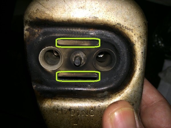

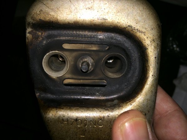

    Tried to capture the essence, with varying success. The first photo is looking into the muffler (from the rear), showing factory holes top left/right. The next photo is obviously the front, and the last one not a very good photo of the bottom left/right from the back.
    The holes appear to be about .2 diameter.
    Is hogging out a bit of the existing holes enough to unleash gobs of horsepower?:rofl: :lol:

  10. clemsonfor
    clemsonfor
    15,996
    37,472
    Greenwood county SC
    Hog those bad boys out as much as you can and then the deflector

    You can certainly open up the holes in the baffle but there is an even bigger restriction in these. Look straight in the exit slots on the front, see that flange that partially obstructs both of them? Grind that clear and enlarge each exit slightly. (See areas highlighted on your photo.) Then pound the front of the deflector slightly convex to open it up a tad.
    saskwoodburner likes this.

    I'll start right there. I don't have the right attachment for my dremel, but I think a few holes and a small file should get me where I need to go. I never even thought about the how choked up the deflector is making everything.
