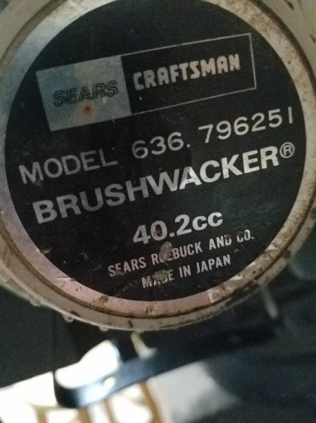

    My old weed eater called for 16:1. Been using 40:1 for 25 years, still runs fine. 20160526_204936.jpg
