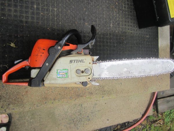

  15. isaaccarlson
    isaaccarlson
    Sep 29, 2014
    1,523
    8,943
    Colfax, WI
    The bar on my ms390 is 15 years old. It has seen heavy and even commercial use. I have dressed it several times over the years and it will need to be replaced before too many more years go by. I would be very happy to get 20 years out of the bar. The engine is still making good power, but is showing some age. I have never touched the carb. It always starts.

  16. buZZsaw BRAD
    32,982
    202,531
    Any pics? Any paint left on it?
    When i sold my circa 2010 MS290 a couple years ago bar had almost no paint on it. Only ran with a 16" bar that i flipped and dressed regularly.
    EDIT: found a pic IMG_2583.JPG

  20. isaaccarlson
    isaaccarlson
    Sep 29, 2014
    1,523
    8,943
    Colfax, WI
    Yeah, I'll try to snap a picture tomorrow.
