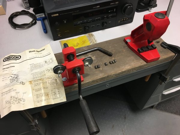

    I have mine mounted to a piece of 2x6 and I clamp it to whatever work surface I choose.

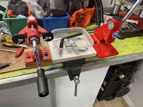

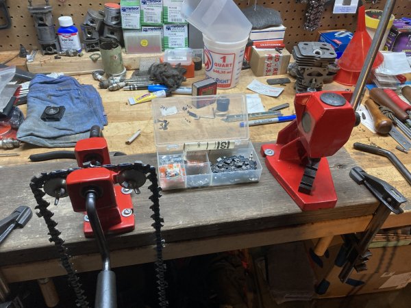

    I have a similar setup as Jason The Wood Wolverine
    I just bought a new set of breaker and spinner. Mine is set up on a 2x4” that clamps into the vise. I put a small container on top of a 1x6” piece in the middle, to hold the extras. The 1x6” piece makes it easy to just drop the whole thing onto the vise. Looking back I would have made the 2x4” a little longer, but this works fine. My shop is small, so I try to keep things compact.
    Edit: I also have a 2x8” that I laid out a chain chart on to measure lengths and whatever. Easy to get out when needed, and put away when not in use.
    Don’t mind the messy bench :whistle:
