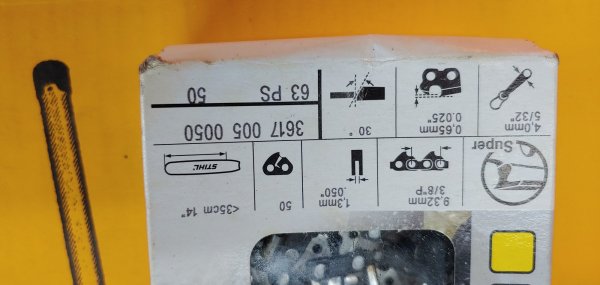

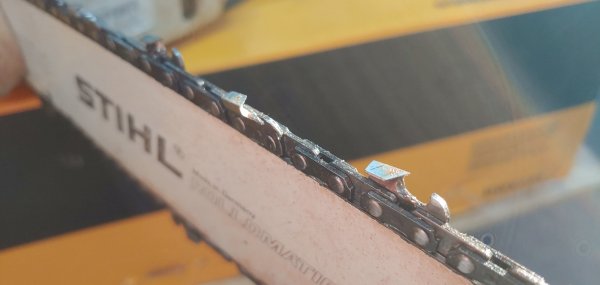

    168,859
    1212211631.jpg 1212211631a.jpg 1212211631b.jpg System I finally got the pictures of the 3/8LP chain
    System likes this.
  16. System
    System
    Dec 15, 2020
    617
    3,125
    Western MA
    Thank you sir...
