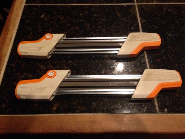

    IMG_4233.JPG This...all you'll ever need, takes care of both...

    Dat's zakly my thought too. Just looks like a good way to trash a file.
    Eric VW, thistle, XXL and 3 others like this.
