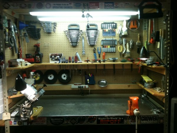

    They day I made the bench, when it was nice and clean. I made it at chest level so you can see what is going on easily without bending over.
    I like a lot of LIGHT too.:bug::binoculars:

    damm sweet setup

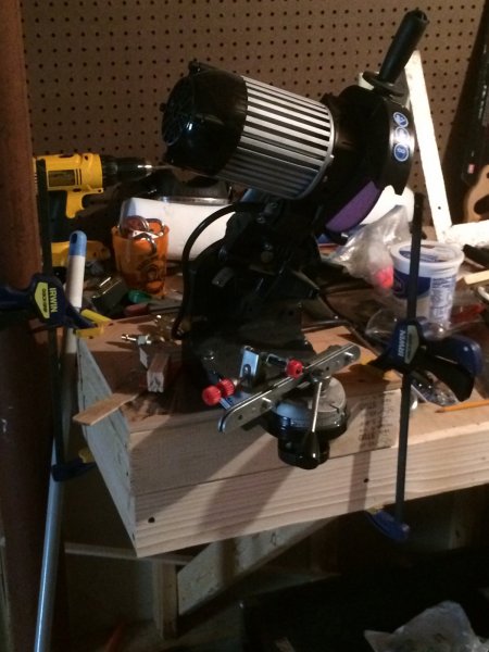

    My 4 year old son helped me build the box that my sharpener is mounted on. Clamps hold it in place on my workbench. If it's in the way, I can release the clamps and move it temporarily. Workbench is a MESS!!!

    One tip I forgot about is putting a big magnet behind the grinder. It will catch a good chunk of the metal filings. The middle grinder has one in the pictures I posted.
    The magnet will look like it has grown a beard as time goes by.:like:
