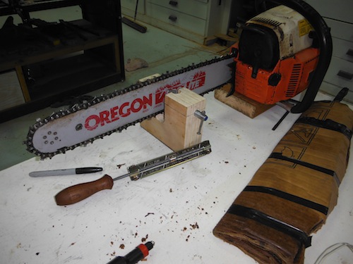

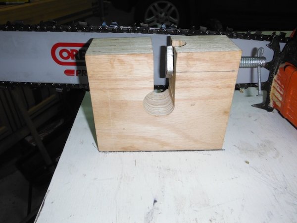

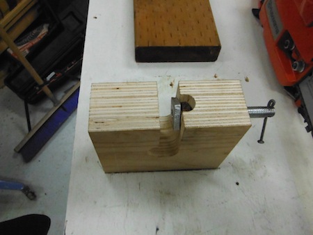

  6. bogydave
    Good idea, a vise help a lot when hand filing.
    Made a vise a few years ago
    & screwed it to a piece of 3/4 plywood
    nice & portable,
    can clamp the plywood to a table, bench , PU tailgate, ATV front or rear rack . . . .
