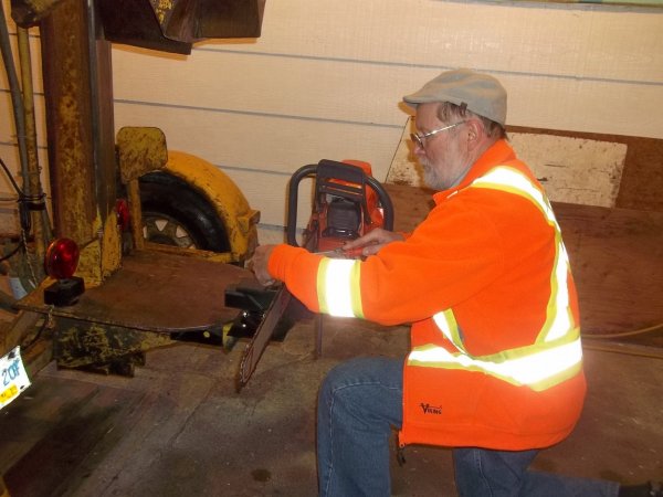

    I've always had good success sharpening the chain from the right side in the bush but not the left, so I tried as much as possible, to do the sharpening at home in the vice and now I finally thought of a way to do it while out cutting wood!

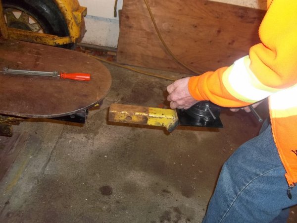

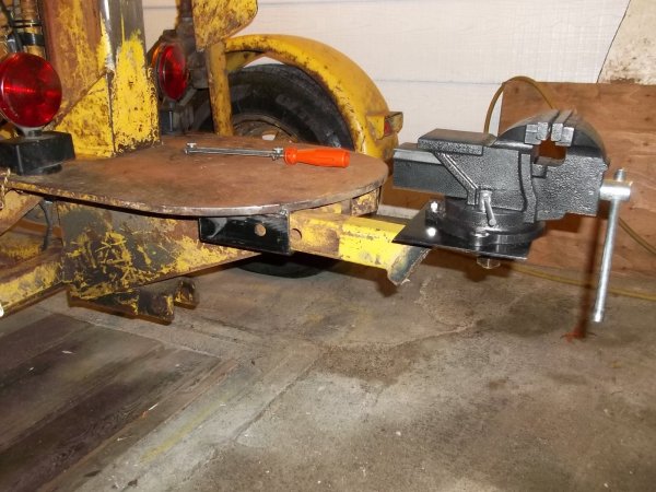

    I had a receiver tube welded under the splitter table and mounted a vice on the receiver.
    Just a perfect height for filing.

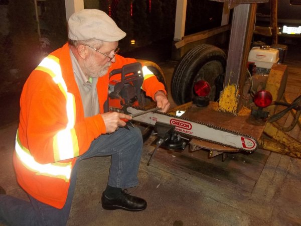

    Now I can get a good filing job on the left side.
    When you're filed up, take the vice out and store it and go back having fun processing wood!
