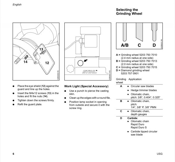

    I have a Stihl USG grinder and found the best place to get a wheel is from a Stihl dealer. 6459FAC8-8F74-446D-A3EA-67F4884E675F.jpeg this should help you to order the correct wheel. I think they were around $25 last time I got one

    Perfect. I’ll head that way. If I can get in and out of the dealership with only spending 25 bucks, it’ll be a great day!

    They didn’t have one. But there was a full wall of saws. Luckily I had to be somewhere so no time for getting myself in trouble!
