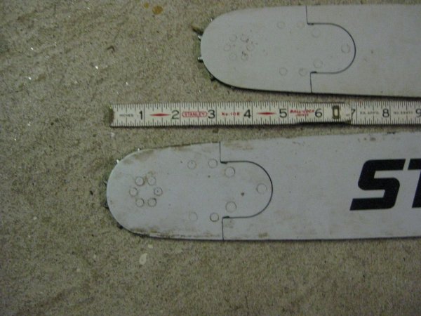

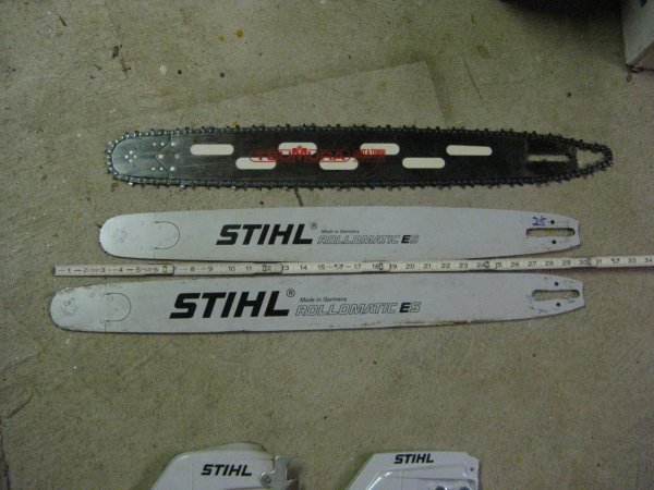

  5. buZZsaw BRAD
    31,945
    194,121
    Just checked and identical. IMG_0533.JPG In Stihls defense the 28" bar is 3" longer so thats why its 25"??? IMG_0534.JPG
    Screwloose and Horkn like this.
  6. Swanman
    Swanman
    Jan 23, 2021
    115
    765
    NW Montana
    I measured about exactly 1 1/2 inches of usable bar difference between the 361 with a 24” bar and double dogs and the 500i with a 28” bar and r version double dogs. IIRC it was 25 1/2 inches usable vs 24. I gotta get a 32” lightweight for the 500. I doubt that I would ever take it off. Just a few more teeth to file.
