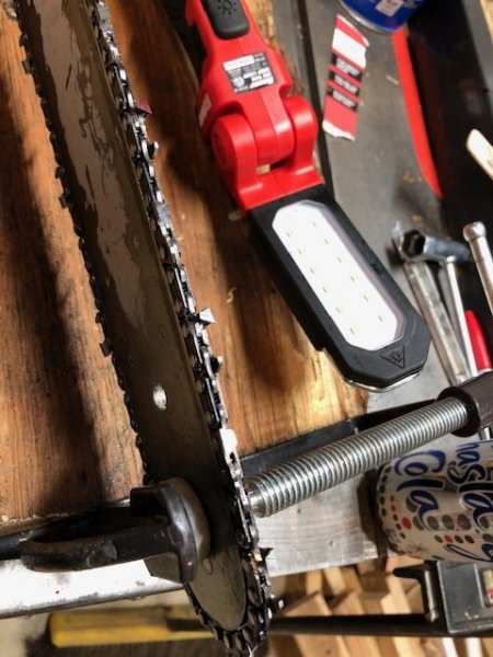

    Double bevel file on the MS250's bar and square filed .325 chain. The light sits right on my sharpening fixture and I can easily position it out of the way but so I can see much better. The 3/8 chain is easier to file, but after getting used to cutting with square filed chain, I just can't go back to round filing.

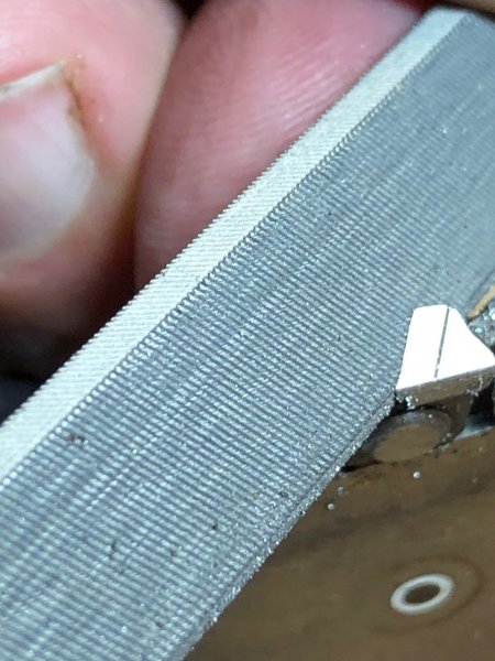

    I can now easily see to keep the file in the corner of the tooth.

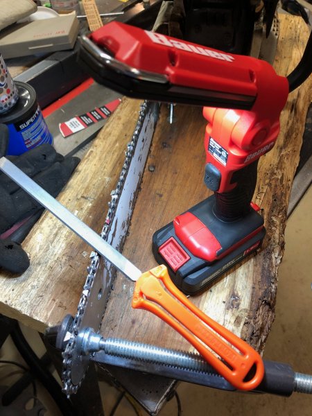

    Side plate showing the undercut of the small round file I use to clean the gullet out first below where the double bevel file cuts the side plate at a near vertical angle. I try to keep the side plate angle 5 to 10* off vertical so it self feeds while cutting wood, but keeps plenty of strength at the corner. I only like the double bevel to cut down the side plate .040" to .080" to make it easier to file. That is fine since I set my rakers to cut .025" thick chips. I find it much harder to file smoothly if the double bevel file is trying to take a full cut on the side plate, especially if the second corner of the file is cutting down in the gullet. I only ever want 2 surfaces of the file cutting at any time. When the third surface is also cutting down in the gullet, it makes the filing action grabby and inconsistent.
    This picture has some glare at the corner tip of the tooth and makes it look like there is a beak on the top plate, but that is just an optical illusion due to the glare. Note the angle line at the back of the tooth is also obscured by glare. Sorry for the crappy photography.

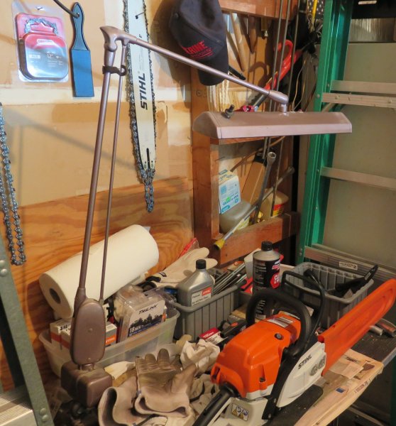

    I am using my old drafting light on my saw bench. Drafting Light on Saw Bench 09182023 (1).JPG
