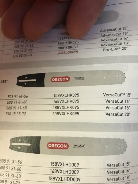

    We are all learning and helping each other here everyday ! :handshake: By the way rusty junk is my thing.... :binoculars:
    As far as the chain I must have seen the wrong picture when I looked it up earlier. :rofl: :lol::picard:
    Just for the heck of it this was what’s in my Oregon catalog 2A887CD9-53C3-414A-8A8F-D9EEA953902D.jpeg 2E30FA23-4D05-4A54-83F7-BBBAC2066E6F.jpeg

    Oooh, I have the Oregon 188SLBK095.
